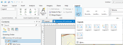

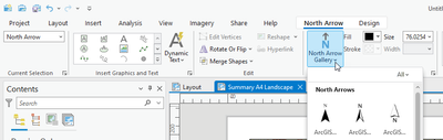

Text and graphics symbol galleries look different than more complex elements like scale bars or table frames, but the location on the ribbon is the same. Examples of multiple galleries, as well as the Save to Style button, are shown below.
I hope this helps!
