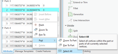

You can flash a part of a selected multipart feature from either the Attributes pane Geometry tab or Edit Vertices with the following steps:
1.  Right click on a vertex in the part you want to flash
2.  in the Part pull right, choose Select All

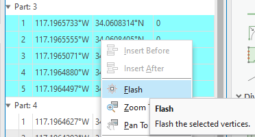

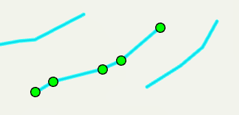

3.  right click again over any selected vertex and choose Flash
