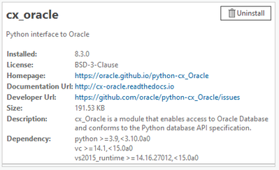

A new user in our group was unable to install cx_Oracle in their cloned ArcGIS Pro conda environment. Looking at cx_Oracle in the Package Manager, I see it's listed as having a dependency on "python >=3.9,<3.10.0a0". Since ArcGIS Pro 3.3 comes with Python 3.11, this would make it incompatible with cx_Oracle.
As mentioned on the cx_Oracle homepage, cx_Oracle is an outdated library that has been replaced by python-oracledb. The python-oracledb driver library should be made available to be installed through the package manager. For context, cx_Oracle has not been updated since November 2021.
That said, if adding python-oracledb to the package manager will take time, perhaps in the meantime the upper constraint on python<3.10.0a0 could be removed for the cx_Oracle library to allow it to be installed in an ArcGIS Pro 3.3 conda environment.

DanPatterson
the upper constraint of python isn't the case, it was caught in the last days of the beta and notices of that update will be fixed during the first update to Pro 3.3.
I can't comment on that particular package, however.

As @DanPatterson mentioned, if you are using Pro 3.3 the Python<=3.9 dependency is misstated in the package manager.
The bug you are describing falls into a class of issues on the Package Manager that we are aware of, it also commonly affects packages like untools, pytorch, and a others.

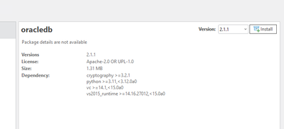

The latest package available on anaconda's main channel is a bit behind what's available on PyPI or conda-forge. You can also try to install oracledb now with a conda command from the command prompt:
conda install oracledb
