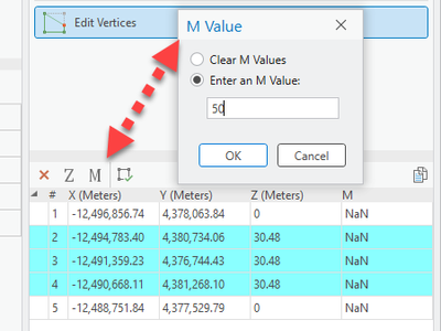

For basic batch updates to Z and M on selected vertices, you can use the Update Z Values and Update M Values commands:
https://pro.arcgis.com/en/pro-app/latest/help/editing/edit-vertex-z-values.htm
https://pro.arcgis.com/en/pro-app/latest/help/editing/edit-vertex-m-values.htm

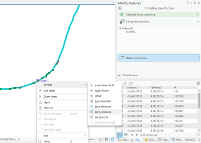

Example:
For more complex updates to M values on a subset of a route, you can use Define Line Portion along with the M Value context menu commands: https://pro.arcgis.com/en/pro-app/latest/help/editing/define-a-portion-of-a-route.htm
