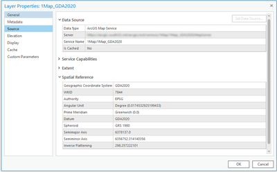

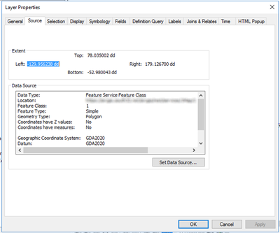

As shown below, ArcMap will honour the GDA2020 service spatial reference for both map and feature services. Pro will honour the GDA2020 service spatial reference for the map service.

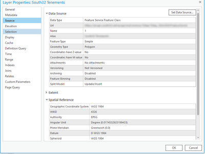

Pro will not honour the GDA2020 service spatial reference for the feature service, instead it uses the source spatial reference WGS84.

Pro 2.9.3 treats layers from feature and map services differently.
  • In a map service it will use the map service CRS
  • In a feature service it will use the layer source CRS.
For example if I add the same GDA2020 map service (with layer data source WGS84) to Pro as a map service and feature service, it will read the layers from the map service as GDA2020 and the layers from the feature service as WGS84. I can check this by setting the transformation method in Pro to "none", and the data no longer overlaps.
