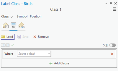

The current symbology is basically a really, really low-tech SQL editor and doesn't allow you a lot of choice out of the box. You can symbolize by unique values field by field or with Arcade, but you get limited to just whatever fields you feed it. Even manually adding values (green plus sign) limits you to the field(s) you've provided already.
In the example provided, there are three fields in use across 8 symbol classes: Asset_Group, Asset_Type, and Status. As it currently stands, to get this sort of symbology, you would have to symbolize by all three fields, then manually group the ones you want into the final 8 classes. Taking what's been provided, Asset_Type has 5 given options, Asset_Group has 2, and Status has 2. That's 20 different permutations that Pro spits out at you, and honestly, having only 2 options in any given field is kind of rare.
So, from a simple ease of use standpoint, I think this would be helpful.
The other thing is that this exact functionality exists for label classes already, so it would follow that it exists for symbol classes.
I think having some sort of toggle under unique values, or adding a Unique Values (SQL) option to the dropdown would be helpful.
