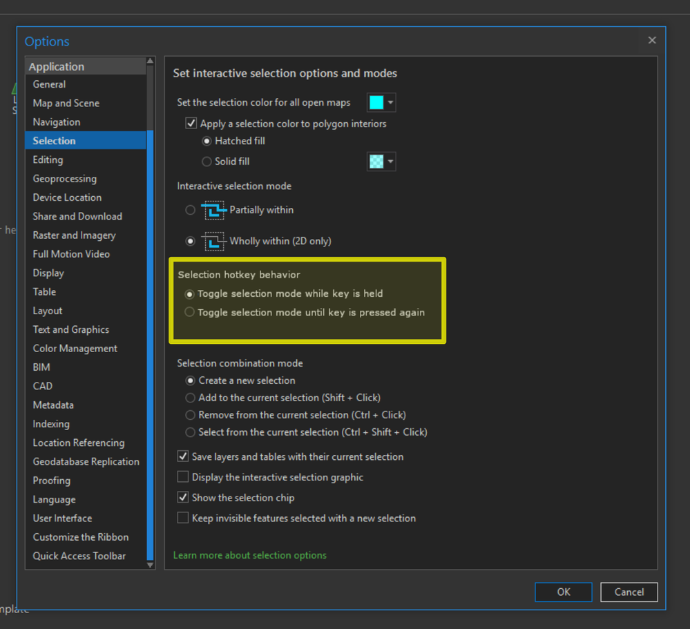

Proposed Solution
I do like having the "hold-down" behavior in certain circumstances, so I don't just want to revert this back to what it was like in 2.8.2.
What I envision as the ideal solution is to give users control over this behavior:
Selection settings with hotkey behavior exposedSelection settings with hotkey behavior exposed

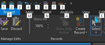

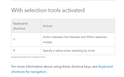

Ah, y'know what, this can be closed. I accidentally discovered that Alt+Y does what Y used to do.
This section of the keyboard shortcuts page just needs to be updated:

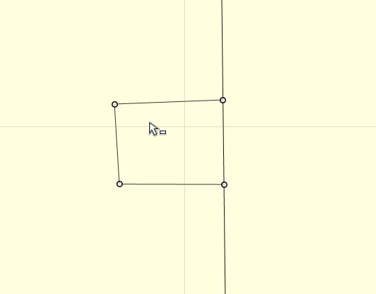

As for now, the expected behavior is that you need to hold down Y while making the selection to switch the mode and should receive visual feedback in the sketch:
Not holding Y:
Holding Y:

Maybe hitting Alt, which normally opens up the keyboard commands, makes the Y-hold "stick" by interrupting the interface in some way?
The oddest part is that it persists for more future selections, but nowhere else in the application does it behave as though the Y key is being held.
