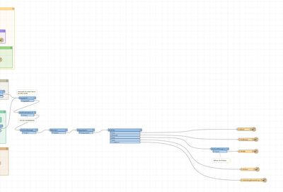

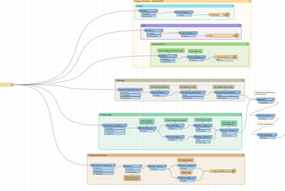

DA_BIM-GIS
Hello @Oberbossel and @OleSeidel1
Here is an example of of FBX to IFC 2x3, but the principle works for fGBD (multipatch)
cc @BruceHarold
