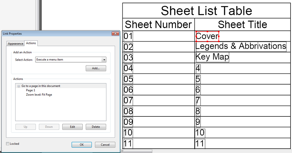

This post is specifically about linking between pages of a PDF rather than hyperlinks. Has anyone seen how AutoCAD through its Sheet Set Manager handles linking pages of a PDF to a master page? Bear in mind that all of the pages are in the same PDF. I have very little knowledge of it but can say that it uses what we would call Dynamic Text as the basis of a link that goes from a master page to a child page (or index page to detail page). There is some setup involved but it is mostly automated. I've given a vague description and there are more details to how it works. The inserted graphic shows what is setup by AutoCAD in the PDF.
A couple of possible issues. Do the folks at GeoPDF stand to lose substantial market share if ESRI builds this into ArcGIS Pro? Has Autodesk built their own comprehensive PDF object library, which ESRI does not have, at least to this broad of an extent? Or did Autodesk purchase a PDF object library which ESRI does not have?
Just trying to spur some thoughts about how the ESRI developers might implement links between the pages of a PDF.
