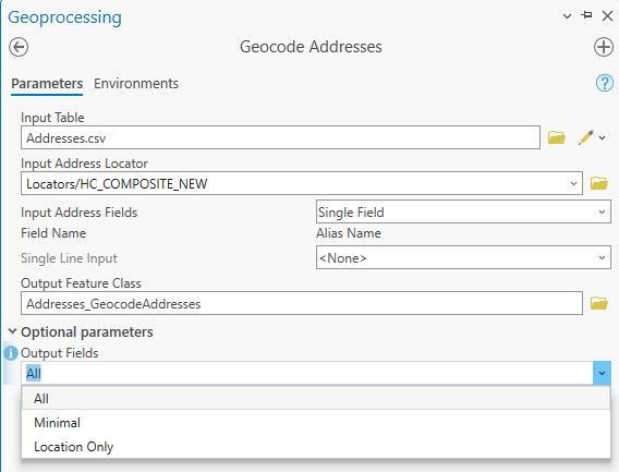

We're currently using Pro 3.0.3, and this is what we see. The only optional parameters have to do with the output fields. Was this a 3.1 add? If so then it'll def be a reason for us to look at upgrading, this will be an excellent new feature!

@JohnNergeBrooklynPark My screenshot shows the Category parameter, but my locator is not a composite. The parameter does not show for you in 3.0.3 because it is a composite; however, it does show in 3.1, but is not working as expected. This is the issue that we are aware of and looking to fix in an upcoming release. Once the Category parameter is available for composite locators, you will be able to specify that you only want PointAddress matches returned.
