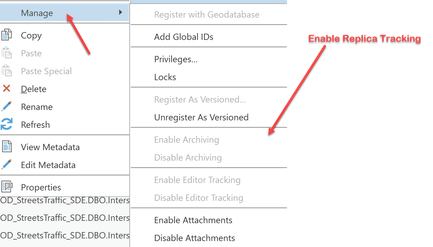

Create Replica Tracking User Interface when right clicking on an Enterprise Geodatabase object.  Go to manage and add Enable Replica Tracking.enable replica tracking UI.png

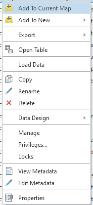

@SavageTrimble  - can I ask where you get that menu to pop up in your original post? When I right click on EGDB object in the catalog pane, I only get these options. Oddly, I have to click Privileges, then exit out, and then right click again on the object to get "Manage" to appear. But Manage is simply a button that opens a dialog, not a menu. I am on Pro 2.9.1

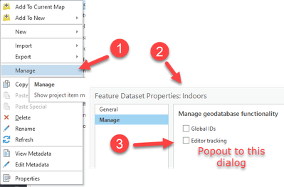

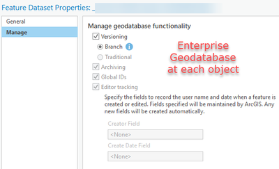

@MKF62 - It pops out to a different dialog.  The functionality is more intuitive if you are dealing with branch versioning as it automatically turns on what's necessary for supporting branch versioning.  However, this process has yet to be batched between like objects unlike ArcCatalog.

@SavageTrimble Interesting. Your menu looks very different than mine when you right click on your EGDB (the screenshots I took in my last reply were me right clicking on a feature class in my EGDB, not right clicking on the actual database). I have no Manage button for the EGDB itself and I have a lot of buttons related to the general connection properties, the geodatabase connection, properties, and the geodatabase itself properties, plus many more. I wonder if it’s because ours is not branch versioned or even if we’re using a different server type (we use MSSQL Server). Ours is simply non-versioned with archiving and editor tracking enabled on specific feature classes. Thanks for the response.

@MKF62 - This was on a feature dataset within the file geodatabase.  Enterprise geodatabase will allow you branch versioning capabilities and more functionality will be in the dialog for those databases. In a file geodatabase, you'll only see compact as an option.  In the enterprise geodatabase, you'll have administrative controls and on each object you'll have the manage dialog.   I hope this helps.

@SavageTrimble  Ohh, I see why mine is different. I was right clicking on an enterprise geodatabase feature class, not a feature dataset. The context menus for each look different. I appreciate the clarity!
