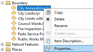

In ArcMap you can right click on a lyr file in the catalog panel (or ArcCatalog) go to properties and reset the data source path and this updates the lyr file. You are then able to add the layerfile to the map and display the data.

At our organization, we keep layer files with read-only permissions for users on a network drive for standardized symbology. In ArcCatalog, you were able to right-click on a layer and choose properties to edit the layer file properties.
In the Catalog Pane and Catalog View in ArcGIS Pro, this functionality is lost.
Users should be able to modify layer file properties from the Catalog Pane or View as they were able to in ArcCatalog.
