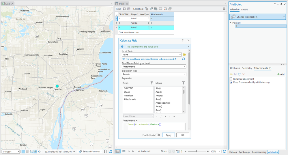

Something you could try in the meantime would be to add an Attachments field to your table and calculate the field using Count(Attachments($feature))
That would allow you to sort/select/filter on which features have attachments.
