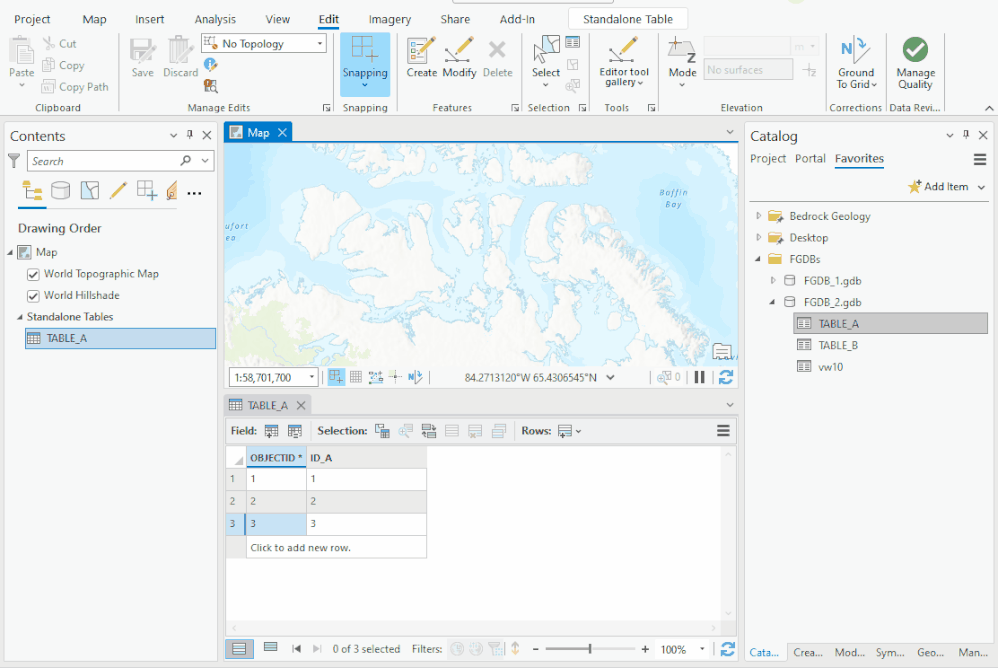

ArcGIS Pro 3.0.3 file geodatabase standalone table:
I've created a new row by clicking the "Click to add new row" pseudo-row.
I've entered the number 4 using the keyboard.
Now, I want to create an additional row by hitting the down arrow key.
But when I hit enter or the down key, the only thing that happens is the "Click to add new row" pseudo-row gets highlighted. I can't proceed to create a new row using the keyboard; typing has no effect.
Could that behavior be changed so that hitting the down key after creating a new row automatically creates a new row? (highlighting the cell in that same column)
Like this:
Additionally, clicking or double-clicking "Click to add new row" has inconsistent results. Sometimes, clicking or double-clicking that pseudo-row works as expected: the row becomes editable with the cell value selected. But other times, clicking or double-clicking that row has no effect. The user needs to smash the mouse a few times to make the row editable, which is a frustrating experience. Could that behavior be improved as well?
When the "Click to add new row" is highlighted, hit the Enter key which serves as a way to "click" that button using only the keyboard and not the mouse.
As for the part about single-clicking vs. double-clicking, "Click to add new row" only needs to be clicked once to add the row. Taking a brief look at this, if you double-click, the first click adds the row and then the second click of the double-click appears to activate the cell under the area where you clicked, but honestly from looking at it, single clicking does the same thing as far as I can tell. I haven't seen any inconsistency in that behavior.
Bud
Thanks @KoryKramer.
As far as I can tell, after populating a cell, I need to hit enter three times in order to create & enter the next row/value.
To me, hitting enter three times seems slightly excessive. I think in ArcMap it was easier -- just hit the down key and start typing.
