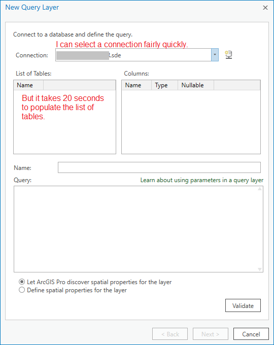

Part of the problem is that we need to connect to the database in question when creating the query layer. That takes ~20 seconds, which is an eternity when you're in a hurry.
Could the Create Query Layer window be changed so that it re-uses existing database connections that are already connected in Catalog? In other words, why do we need to re-connect when there is already an open connection?

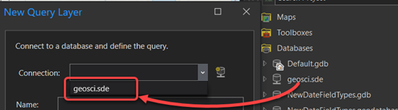

The New Query Layer dialog does show database connections from the Catalog pane.
are you not seeing them? or are they not working for you?
Bud
@TanuHoque I can see the .SDE connections in the New Query Layer dialog, yes. But those connections are not open/connected. I would need to reconnect to a .SDE connection in the New Query Layer dialog in order to use it to create a query layer. I want to avoid the reconnecting step since connecting takes too long. The connection would ideally be pre-connected in the New Query Layer dialog, if it’s already connected in catalog.

TanuHoque
@Bud
Ah, I see... I'd expect it be connected from that dialog too, if you already have it connected from the Catalog pane. I will bring it to the team.

Or, maybe the slowness happens when the Create Query Layer dialog populates the List of Tables section:
I suppose I could just ignore the fact that the List of Tables takes 20 seconds to populate. Since I don't usually need that list; I just write the SQL manually in the Query section.
I didn't realize until now that I can write SQL in the Query section while the List of Tables is thinking.

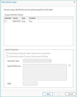

Some changes that could be made to that dialog that would save time:
  1. Don't force me to click Validate. Let me attempt to create a query layer using the inputs that I've entered.
  2. Automatically use the OBJECTID column, if it exists and is an integer:
  3. Any other ideas?

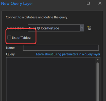

TanuHoque
@Bud
With one of the newer Pro versions, you have the option to list tables only when you need them. This should help.
