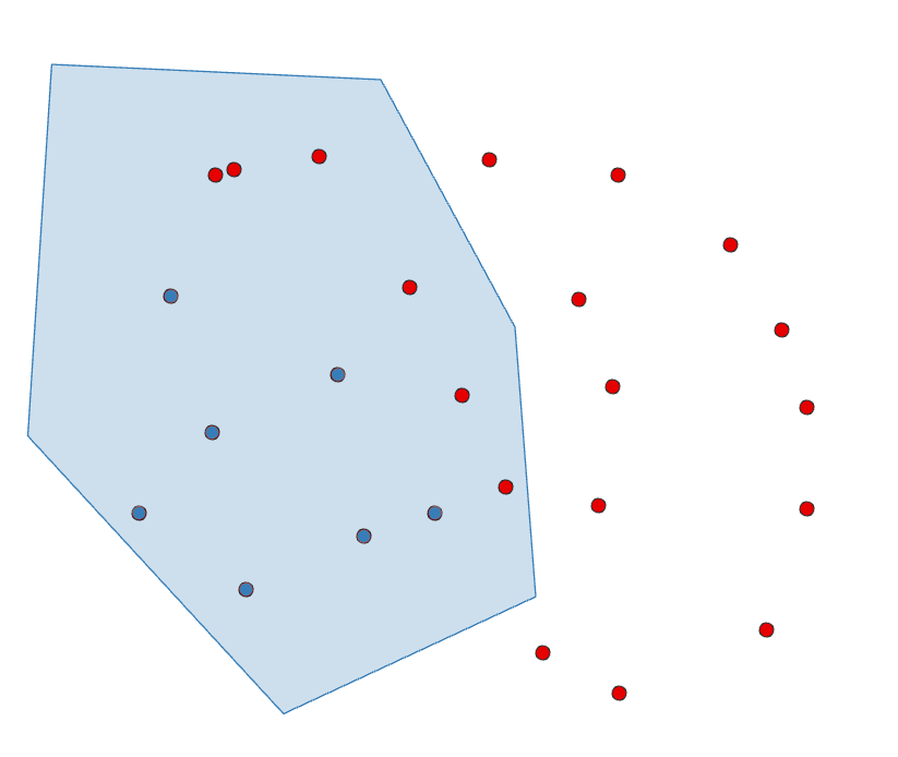

The inclusion of spatial based definition queries to 3.5 is great. My immediate thought was to check if they were dynamic, i.e. if my polygon extent changes does my definition query update accordingly. The answer is no. It sticks with the original geometry unless you go back in and reapply the query.
I think there should be an option to allow this to be dynamic (it would be for attributes). I might be using a polygon I don't control / have ownership of and don't know if it has changed. My queried data would be out of data in that case.  (see my picture example below. Blue points are in the definition query. I updated the polygon extent but the blue points are not changed).
Red points not captured when polygon extended. Blue points are part of definition queryRed points not captured when polygon extended. Blue points are part of definition query

Although I understand the value of having this functionality dynamic, and I don't think implementing a naive approach to it would be difficult, the fact that spatial operations are so compute intensive makes implementing an efficient means of doing it very challenging.  For the example given here, even a naive approach would likely perform fine, but what happens when there are millions of points or the polygon itself has tens of thousands of vertices?  In that case simply panning or zooming a basic map would result in the noticeable, if not significant, delay in refreshing the screen.
Raising ideas is good, and I think the discussion around them in the community is good for Esri to read, but this is one where I would not hold my breath.

@TanuHoque the workflows I have in mind are similar to @RTPL_AU. A whole bunch of figures which need updating because a project boundary has now changed. We already have python scripts that work through folders and aprx and export all the figures. It would be amazing if any spatial definition queries are also updated based on current boundaries. No need to open the APRX at all.
Another workflow would be for intersect counting. The project boundary may stay the same but the national designations might have been updated (e.g. historic listed buildings) and we could set up dynamic spatial definition queries to easily get an output of how many and which ones are in the project boundary. I know we could just so select by attribute etc but the ability to do this via dynamic definition queries adds another option, especially to those in the team that aren't as experienced in Python scripting.
I understand the points that a dynamic set up might be more intensive and as such might be best served with an option to turn ON dynamic updates. So the user can select if that is what is needed for their specific project. Maybe even limit the dynamic updates to only when the APRX is opened rather than continually checking for changes if that causes issues.
