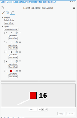

Another question: these points represent bird observations, (each color representing a different species), and some points represent more than one bird observation for a particular species. I was originally using labels to display the number of birds, if the point represented more than one bird observation. Now that some of these modified points are labels themselves, is there a way to offset a number label to the side of this new symbol-label? I figure I can use graphic text as a workaround.
Update: I played around with 'Format Point Symbol' under Callout. Since I didn't see any halo effects, I created two extra numbers in white in bold with bigger outline widths in white to go under the black numbers. All of these number were offset from the square point.
I feel like I am close, but it's not 100% what I want. The font, even though it is the same format as the regular labels, the numbers don't quite match.

Numbers not matching label style:
The black 16 in the image looks like it might have a stroke on it because the letters look "rounded" - or it could be you're just using a rounded looking font. But if you're adding a stroke around the black text it will look different than label text because the added stroke rounds out the appearance of each character.

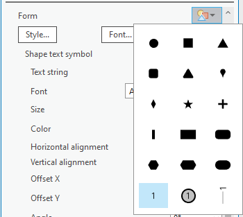

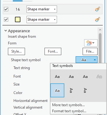

Using Shape text symbol for numbers in icons:
Instead of adding a '1' and a '6' twice each to make '16' with a halo, you could use a "Shape text symbol" with the "White halo" style in 1 layer.

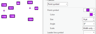

Label marker symbols with dynamic text:
Making individual label classes for every icon with various quantities of observations could be tedious if there are many different amounts to create symbols for. Perhaps you could label the squares with the number of observations inside the square. Then you may only need a couple label classes - one simple square where there is only 1 observation that uses the blank number. Then another label class that labels the square with the number of observations. You can set the background callout point symbol to scale by width to allow the icon to widen to accommodate bigger numbers.

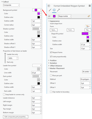

Composite Callout:
Another idea is to use the Composite callout symbol. It takes a little more configuration with various Text formatting tags, but you can achieve something similar to what you're describing and allow for dynamic labels to be used.
In this example I use this label expression to set following:
  • Set the placeholder asterisk to the middle position of the composite callout.
  • Change the color of the placeholder asterisk to transparent.
  • Place the objectid field label in the right position of the composite callout and offset it 5px to the right.
"<PART position='middle'>" +
"<CLR red='255' green='255' blue='255' alpha='0'>oo</CLR></PART>" +
"<PART position='right' x_offset='3'>" + $feature["objectid"] +
"</PART>"
Then I configure the Composite callout symbol so that the background is actually a point marker symbol centered in the polygon.
The final symbol looks like this:
