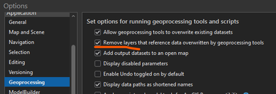

@Bud How do you have 'Remove layers that reference data overwritten by geoprocessing tools' set?
I'm not sure if updating the query layer through geoprocessing counts as an overwrite, or what the result would be but what happens if you do your workflow with that unchecked? (Because the "attribute table disappearing" is just happening because the table layer is being removed and the new one added back, meaning you have to re-open that new table layer's table.)
https://pro.arcgis.com/en/pro-app/latest/help/analysis/geoprocessing/basics/geoprocessing-options.ht...

Hi @KoryKramer. Good question. I tested the 'Remove layers that reference data overwritten by geoprocessing tools' setting just now. But it doesn't seem to have an effect in this case. The attribute table of the query layer gets closed regardless if the setting is enabled or not.
