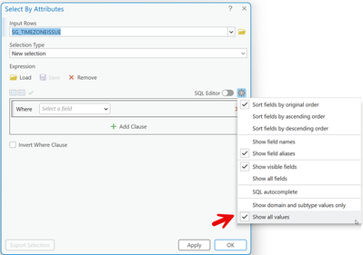

TanuHoque
@KimberlyWinter
The Query Builder control whether hosted on the Select By Attribute gp tool or on a layer's Properties page inside Definition Query, provides an option for you to opt into the mode to display only existing value from the selected field. By default, the query builder control shows values from the domain or subtype associated to the selected field.
I hope this will resolve of of two issues you mentioned here.
