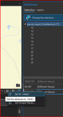

Personally, I have found the easiest way is to select the records you want to set fields to Null, then open the Attributes pane, select the root feature class, then right click on the field you want to set Null. From the right click menu, select "Set to '<Null>'".

If anyone's wondering, here are the docs for the functionality @RandyCasey mentioned:
Edit feature attributes:
https://pro.arcgis.com/en/pro-app/latest/help/editing/edit-feature-attributes.htm#:~:text=Set%20To%2...
