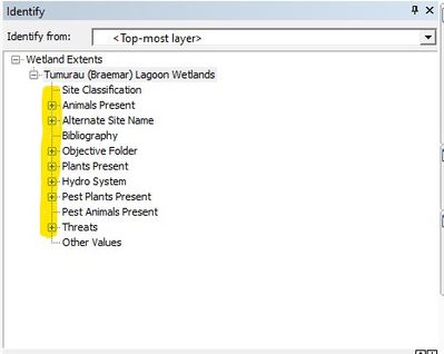

I agree completely and can I add a couple of other things to do with relates.
I have a situation where I have one feature class with 11 related tables.  I know this isn't optimum but we were just trying to get as much of information out of a old database as possible and trying to keep that information available to the organisation.
In ArcMap when I identify a feature I get a list of all the related tables.  First off as talked about in the previous post it only shows the forward label in the identify window which is much cleaner and easier to use than showing the table name as well as in ArcGIS Pro.
As well as this there is plus icon beside those where there are actual records related so you know which you can ignore.  In ArcGIS Pro you have to open every one to find out if there are any related records or not and this process is SLOW.  In ArcMap all the records are selected in one hit, it takes about 2 seconds to do this.  In ArcGIS Pro it doesn't seem to check for related records until you open the related table and then it takes forever to find them all.
I would like relates to work in ArcGIS Pro the same as in ArcMap - please?Screenshot 2021-11-08 091450.jpgScreenshot 2021-11-08 091450.jpgScreenshot 2021-11-08 091524.jpgScreenshot 2021-11-08 091524.jpg
