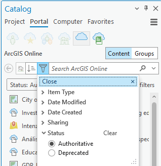

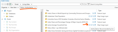

Do you use the available filters?
There are filters and indicators in the Add Data experience as well:
Can you please review this information and clarify the idea given the existing functionality?
Thank you
Slamon
Hi Kory,
I had not seen the filters, so that is helpful to know.
After applying the filter, I don't see the icons like what you show in your screenshot.  What version of Pro is that?
I think it would be helpful to just see those icons next to the layers without having to apply filters.
KoryKramer
What version of Pro are you using?
It isn't necessary to apply the filter to see the icons, but of course if you are just interested in Authoritative content, its way faster to filter so that you don't have to scroll through bunch of layers looking for icons.
