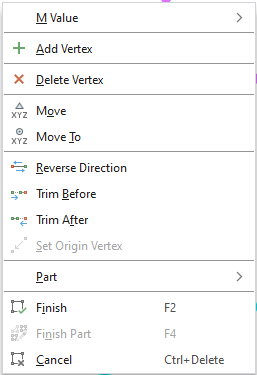

Right now if you accidentally add a vertex while editing with a tool such as Reshape, you have to R click very precisely and without moving your mouse on the point you created and choose Delete Vertex.
Sometimes, it gives you the wrong menu, which means you have to try multiple times to get the menu option to show up.

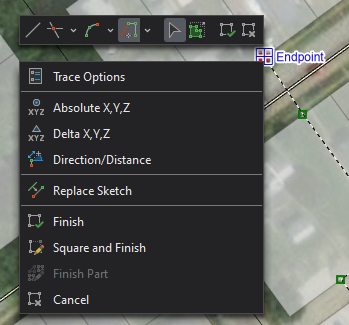

Yet another type of menu from R clicking on a vertex:

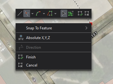

Your request makes sense but I do want to clarify why you are seeing different context menu items, or at least why I think you are based on the screenshots...
In the original comment, second screenshot.  The Direction-Direction constructor is active.  That context menu shows when the constructor is in progress as that is the context menu for that that context.  Need to esc or finish up the constructor to get the desired vertex editing context menu.
In the second comment, the Trace constructor is active.  I don't think the active constructor is important though. I think you right clicked very fast, before vertex editing mode kicked in.

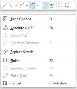

When cursor looks like this, you will get the Trace (or active constructors) context menu
When cursor looks like this, you will get the vertex editing context menu

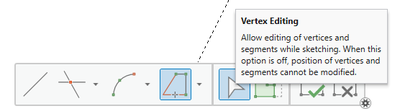

Additional piece of information, you can toggle on/off mid-sketch vertex editing from the Edit toolbar
