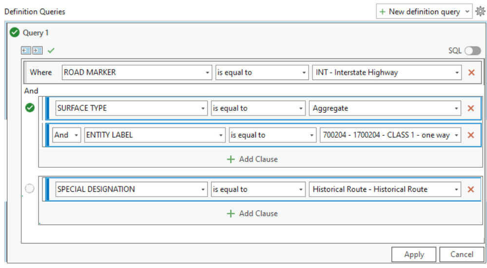

 What I'd like to be able to do is add a toggle to other clauses to let me switch between them more easily.
Here is a mock-up of what I have in mind. I only went down one level, but I think it could be cool to branch it down a little farther.
In this example, I always need to see the interstates, but the other attributes are going to change depending on where I am in the workflow.

The mock-up in the original post only operates on one level:
-- Swapping out part of the query
select * from table
where road_marker = 'INT'
     AND
         (SURFACE_TYPE = 'Aggregate'
          AND ENTITY_LABEL = 700204)
     -- SPEC_DESIG = 'Historical Route'
 It also implies that I can either have that group clause about Surface type and entity label active OR I can have the clause about Special Designation active. I'm not sure if this should be a radio button situation or a checkbox situation. That is, are we swapping different parts of the query in and out with each other or are we turning parts on and off?

The other thing is that my mockup only went down one level. That is, in the group clause, you can either have the group clause, or you can't, but you can't turn off part of it. I'm not sure if being able to turn off part of the group is necessary, but it could also be nice.
-- Turning off part of the group clause?
select * from table
     AND (SURFACE_TYPE = 'Aggregate'
          --AND ENTITY_LABEL = 700204
     -- AND SPEC_DESIG = 'Historical Route'
 Where I'm going with this is that typically the first clause of the definition query (and of a grouped clause, too) is the most important one. I think that being able to turn off or switch the other clauses so you can focus on the important parts as necessary without having to duplicate your definition queries would be helpful.
To be honest, I almost never use the query switcher on the Data tab; I always go to the layer's properties. That being said, I don't think there would be a need to change the Switcher's behavior-- since we'd essentially be editing the definition query, it would make sense to only be able to do this on the Properties window. You're not changing to a different query; you're just editing it for a minute before switching it back.
