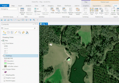

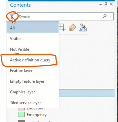

Currently in ArcGIS Pro, the layers in the Contents pane can be filtered to show active definition queries.  For layers with an active query, which query is active can be seen from the Data tab's Definition Query group.
This is a screenshot of the filter:
kdaw_gis
@KoryKramer  I didn't know this existed. Thanks for pointing it out. I still think some sort of indicator on the contents pane would be helpful for users. This is buried in the ribbon and is hard to find for novice users. QGIS has an indicator in the table of contents for definition queries.

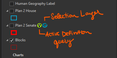

JakeKrall
An icon next to the layers' checkbox would be great! JakeKrall_0-1637002765302.png This would show if a definition query was set.

wayfaringrob
Agree, this would be a neat little enhancement that is not resolved by the filter. Great functionality, but not a solution to the request. It sounds like the idea originator wants this at a glance, not a 2-click shuffle that has to be done and undone whenever they want to take a look. Filtering also (obviously) removes non-relevant layers, and personally, I like context and for my display to not jump around a whole lot - I'd like to see where these layers are relative to others without sending a search party.
The comment about new users or even experts that may not realize a definition query is on should also be considered - they're not going to go filter the list to check on that. And again, the back and forth of it - eh. I agree, a little icon would be a helpful indicator for new users and daily drivers alike. A similar argument could be made for selection layers.
Each icon could also link to the appropriate tab of Layer Properties (definition query icon > definition query builder; selection icon > selection or source tab).
