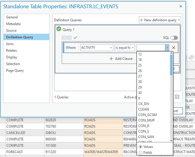

Also, for what it's worth, older versions of ArcGIS Pro, such as 2.6.8, seem to behave differently than what you've described.
2.6.8 shows domain codes from multiple domains.
The first few values in the picklist are from a range domain (numbers). The last few values are from various coded value domains (text). So that seems to be different than how newer versions of Pro are behaving.
