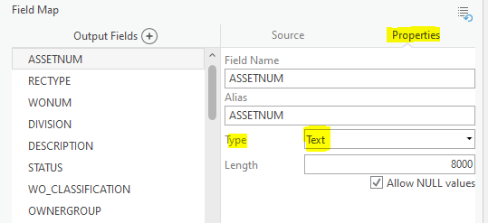

This idea can be closed. I missed the Properties tab:

@Bud where did you find the Properties tab? I'm not seeing it.

Bud
@Heather_Hegi I think it was in the Table to Table geoprocessing tool's Field Map section. I believe that tool was replaced by the Export Table tool in later versions of Pro.
