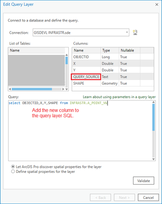

Bud

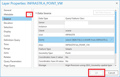

It occurred to me that the view is technically a query layer in the Contents pane. So I ought to be able to re-define the SQL in the query layer, hopefully fixing the issue:
However, the property window hangs when I do that. So I can't hit OK in the properties window to apply the change.
So I can't tell if it fixed the issue or not.
Bud
This idea can be closed. Changing the SQL in the query layer solved the issue.
