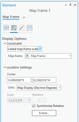

I believe this workflow is supported in Pro with the various linked map frame constraints, specifically linked map frame scale.
