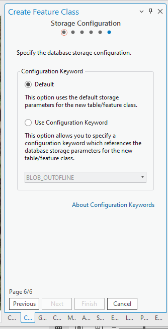

I'm creating a new feature class called Roads.

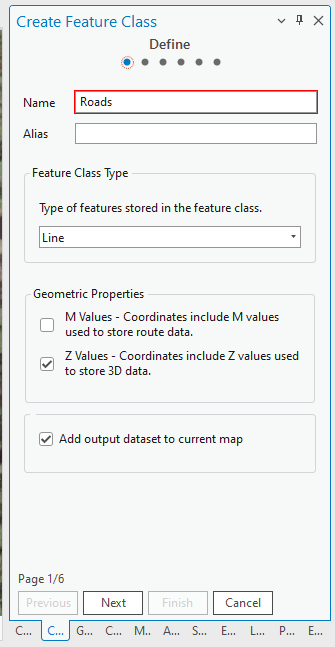

I've overlooked that a Roads FC already exists in the geodatabase, and the Name parameter is outlined in red.
I'm at the last tab (Storage Configuration tab) in the wizard, but the Finish button is unavailable/greyed out.
It's not immediately clear why the Finish button is greyed out.
I'm wondering if it would be more intuitive if there were an indication about why the Finish button is unavailable, such as red text that says "Error in previous tab" or "Error: Name already exists."

Valid idea @Bud Just noting that invalid pages are marked with a red circle and hovering over that indicates that.

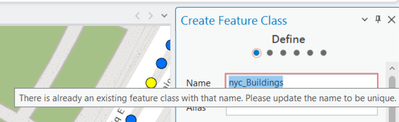

@Bud To add to Kory's comment, hovering over the Name parameter that's highlighted in red will show display tooltip explaining why you cannot click the Finish button in the Create Feature Class Wizard.
