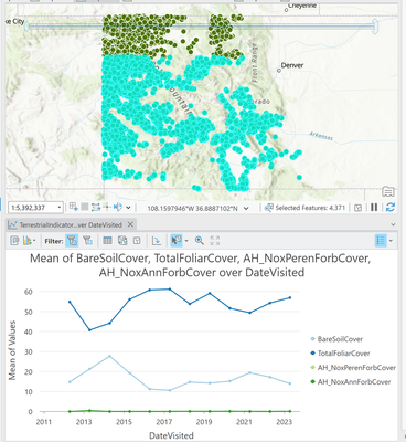

We have field collected data that we create summary indicators for.  We chart these to see how plants change over time.
Like this

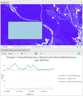

Our data only goes back to 2014 and we have areas that do not have many points yet.  So to supplement we also use remote sensing data that is created from imagery.
Our users would like to see this on one chart.  They need to see if both sources are aligning or wildly different (which could be a data entry error).  It can be hard to compare these when they are two totally different graphics.
