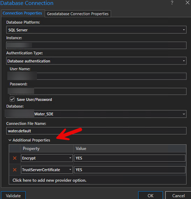

@HannesZiegler There is no way to programmatically or through a batch process update existing sde connection files for the additional properties.  In fact, there is no geoprocessing tool to do this.  Each connection needs to be manually updated.  For medium to large organizations that have many sde connections, this is a problem.  The industry is now leaning towards encrypting database instances via tls connections.  Once this is done for the GIS person who manages the enterprise geodatabase stack, it is very costly and time consuming.  Below is a screenshot of what is added in order to work.  Does this help answer your question?
