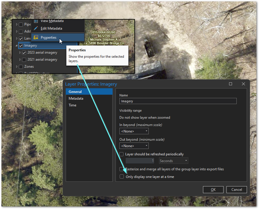

JesseWickizer
Beginning at version 3.2, an ArcGIS Pro group layer has a Group Type property that allows sublayers to either be treated as checkboxes or radio buttons.
Matt-Goodman
Oh, wow! I didn't realize this was coming. I need to update, I guess.
KoryKramer
Thanks for pointing out the existing functionality @JesseWickizer
