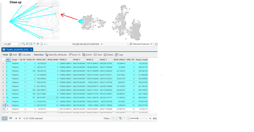

This seems a unique use case. It is pretty easy to analyze distances between points and even create lines from each point to it's surrounding points that are within 300ft, as shown below. The highlighted are 12 lines from IN_FID 1. Thanks for sharing your data.
However, the angle criteria is not clear to me. Could you please explain in detail, or illustrate with some screenshots, what you meant by "the angle between the points must be between 90 and 180 degrees"?  How is the angle between the points defined or measured? Thanks!
