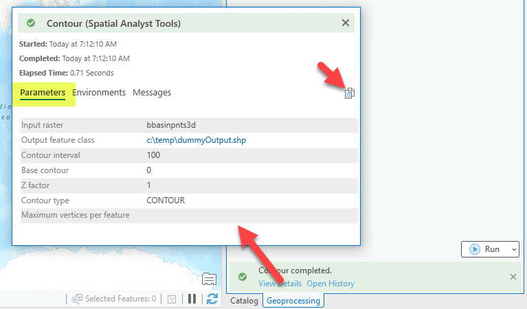

After the tool is run, click on View details, change to the Parameters tab and click on the "Copy all details to clipboard" icon.

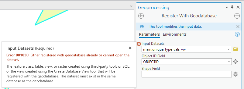

I guess the limitation with that technique is that the parameters can only be copied if the tool is run-able. If we can't run the tool due to "pre errors", or don't want to run the tool at this time (save the parameters for later), then there isn't a way to copy the parameters.

@Bud the "Copy Python Command" is another option that partially addresses your need. It gets around the not wanting to run the tool limitation, as you can fill things out and copy without having to run the tool. It does, however, fall victim to pre-errors; if an error is present, then Copy Python Command is grayed out.
