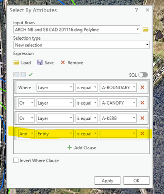

When using the the Select By Attributes wizard allow the duplication/ copy & paste of clause to reduce the actions required when selecting multiple values from the same field.

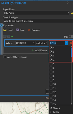

Hey Ellen, this is a great question,
What we could do in this situation is select "Includes the Values" from the operator drop down as per below:
This will then allow us to select multiple values from the one field, as per below:
I hope this helps!

With the need being "to reduce the actions required when selecting multiple values from the same field" this is possible by using the includes the value(s) operator as helpfully pointed out by @Anonymous User
Thank you!
