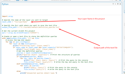

Unfortunately, currently there is no such tool available to copy all the queries at once but it can be done by using python. Please do the following to get the all the queries in the text document.
1. Open the Python window in ArcGIS Pro Project in which you have layer:
2. Copy and paste the below code in the python window.
import arcpy
# Specify the name of the layer you want to target
layer_name = "YourLayerName"
# Specify the full path where you want to save the text file
output_file_path = r"C:\YourDesiredPath\definition_queries.txt"
# Get the current ArcGIS Pro project
aprx = arcpy.mp.ArcGISProject("CURRENT")
# Create or open a text file to store the definition queries
with open(output_file_path, "w") as file:
    # Access the map and layers
    for map in aprx.listMaps():
        for layer in map.listLayers():
            print(f"Processing layer: {layer.name}")
            if layer.name == layer_name and layer.supports("DEFINITIONQUERY"):
                print(f"Found target layer: {layer_name}")
                # Get the definition queries
                queries = layer.listDefinitionQueries()
                print(f"Queries object: {queries}")  # Print the structure of queries
                if isinstance(queries, dict):
                    for key, query in queries.items():
                        print(f"Key: {key}, Query: {query}")  # Print the query to the console
                        file.write(f"{key}: {query}\n")  # Write the key and query to the text file
                elif isinstance(queries, list):
                    for query in queries:
                        print(f"Query: {query}")  # Print the query to the console
                        file.write(f"{query}\n")  # Write the query to the text file
                else:
                    print("Unexpected queries object type.")
4. Change the layer name to your layer name in which have queries e.g your layer name is street in table of content so change "YourLayerName" to "street" .
5. Give the path for the text document e.g you want to store in D drive change the path r"C:\YourDesiredPath\definition_queries.txt" to r"D:\streets_definition_queries.txt"
 6. Run the code you will get the text file containing all of the definition queries which are on that layer

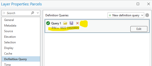

It would be very useful to have a copy button directly in the Layer Properties Definition Query properties dialog.  In my work, I update definition query on multiple layers in multiple layouts and it would save a lot of time to avoid opening each in SQL mode and copying manually.  There is already an option for "Load", "Save", and "Remove".  By adding an option for "Copy definition query syntax/text to clipboard" would save time.  Or if we could highlight the text and copy directly from the menu without having to click Edit.
