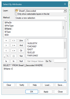

The ArcMap "Select By Attributes" window operates in a single mode that contains all of the functions of both modes of the ArcGIS Pro window.  My idea is to add the SQL expression pane to the ArcGIS Pro query builder window. This would eliminate the need to initially select the mode, make it easier to see the full expression in query builder mode, and make help from the query builder widgets availabe while you type in the SQL expression pane.

For reference, the ArcMap tool for this is below.  Everything is available in one window. You can alternate between the SQL expression pane and the clause building widgets with impunity.  The ArcMap tool is less concerned about whether a valid SQL statement is being formed than the ArcGIS Pro window is.  The ArcGIS Pro window might also need a Verify button and to stop worrying about whether a valid statement exists while the widgets are being manipulated.
