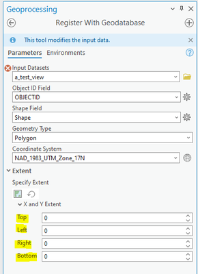

Bud
It looks like the extents parameters in GP tools were changed in more modern versions of Pro.
3.2:
However, they're still not consistent with the properties window. For example, the order of Top, Left, Right, and Bottom is different. So I think this idea still applies.

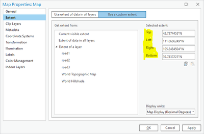

DrewFlater
Since this was labeled for Geoprocessing I'm marking this already offered as the Pro 3.2 extent control shows the order of the extent coordinates match what is used in Map Properties.
If you would like to recommend that feature class Properties be made consistent with the map extent and geoprocessing extent, please submit an Idea with the Geodatabase label.
You have also described that the geoprocessing extent and properties extent have different formatting with commas and other characters. For typical use of the geoprocessing extent, there isn't really a use case for manually copying and pasting of coordinates, as it has buttons to get the extent directly from the map, a layer, or geodataset. https://pro.arcgis.com/en/pro-app/latest/help/analysis/geoprocessing/basics/extent-control.htm
Unfortunately the Register with Geodatabase tool you pictured does not have an extent parameter, rather it is the type Envelope which doesn't support the same things as an extent. If you think it would be beneficial to have these easier ways of populating the extent for Register With Geodatabase, you could log another idea with the Geodatabase label to change the parameter type from Envelope to Extent.
