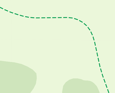

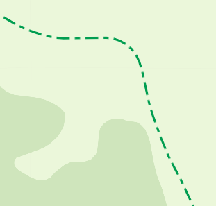

Complex dash patterns (Ex: dash - dot - dash) published as vector tiles work in the regular Map Viewer but do not work in Map Viewer Classic, Javascript API 3.x, or ArcGIS Pro's map viewer.
When I am creating vector tiles, I am using them for multiple maps and I need them to appear consistently across all of them so there is not user confusion. We use complex dash patterns to illustrate different allowed usages of our trails and if it appears incorrectly then that user might think they can do something on that trail that is not allowed.

The only workaround I have found is using Vector Tile Style Editor to change the pattern. I duplicate the layer and change the pattern for each of them to mimic a dash dot dash pattern. This ensures that everyone is at least seeing the same thing.
Layer
Dash Template
Original
1,3
Duplicate
2,6
