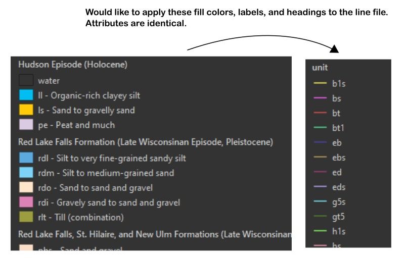

This would be extremely helpful for me. I have a polygon layer with 80+ color categories, all manually grouped under headings. I've also manually changed the "label" text that shows up in the legend.
I have a line layer with an identical field and attributes that exactly match the polygon data. I need all of the same colors, heading groups, and labels in the line file. Image to help describe what I mean:ESRI_Ideas_092023.jpg
There should be an option to apply polygon fill color to the line stroke. The same way I use "Apply Symbology from Layer", but allowing for symbol application between different data types.
