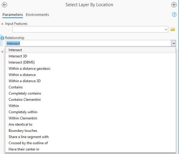

@SteveLynch We're an umbrella organisation with well over 100 users. the question with clip raster by a feature and include the boder cells in the selection is one of the most often asked questions. of couse, you can use a workaround. But it would be so much user friendlier if esri just included the option "select cell if covered" + "less / less or equal / equal / more or equal / more" + "x%" to the GP tools "Extract by Mask" and "Clip Raster" when the Option "Use Input Features for Clipping Geometry" is activated.
something similar exist also for "select layer by location" for vectors - here you can choose the "relationship" for the input and selecting feature (see photo: intersect, within distance, contains, completely contains, within, completely within, are identical to, boundary touches, crossed by the outline of, have their center in, etc.)
It's really a common problem and it would be great to be able to solve this problem in one step instead of at least two...
