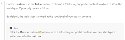

This has since been made available in ArcGIS Pro.
See https://pro.arcgis.com/en/pro-app/latest/help/sharing/overview/web-feature-layer.htm
