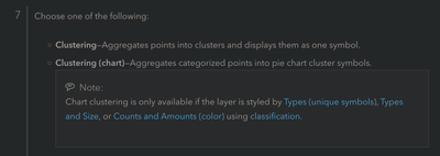

I followed the instructions on this page to turn a point layer into a layer symbolized by clustered charts.
https://doc.arcgis.com/en/arcgis-online/create-maps/configure-clustering-mv.htm
Chart clustering won't work for all situations.  Make sure the data you want to chart is symbolized by one of the following methods before moving forward, because the chart is generated based on this symbology:
ETA:  The data also needs to all be in the same layer using this symbology.  If your data is in separate layers, you'll need to consolidate the data into a single layer first.
