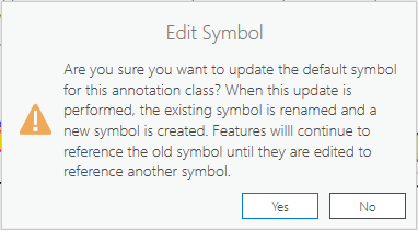

When changing the symbology of an annotation, the following warning pops up:
Why is it set so that features will continue to follow the old symbol? Wanting to change the symbol of all these features is precisely the reason I am changing to a new symbology! Why else would I change it if I want to keep the old symbology? It doesn't even make sense! Else I could just add a new annotation class with a new symbol!

This means I have to use the field calculator to recalculate the SymbolID field, which last time first caused ArcGIS Pro to crash, and then the leaders were missing.
@IlkaIllers1 Can you show me an example of what you mean here?  Do you mean the Calculate Field Tool or the label class expression?  (Thanks for bringing this to our attention)

If you're not looking to make edits to the annotation you should take a look at symbol substitution.
This will change the display of your text without an edit to the underlying feature class.
When you say this worked much better at ArcMap how do you mean?
AndrewWallick
@WendyHarrison @JonathanNeal  We also are hoping to change our default annotation symbol, and I ran into the same warning. I wish that it would let me just make a change, without having to go through and update the attributes of all my existing annotation. Is that the only work around?

In our map production workflow, we rely heavily on the SymbolID field to manage annotations in shared geodatabases. However, with the approach proposed by Esri, changing a simple property such as the font size becomes a real challenge given the many constraints we have to deal with.
For example, we lose the correspondence between SymbolID and AnnotationClassID. The addition of deprecated symbol IDs to the symbol collection further complicates annotation management, while retaining these obsolete symbols provides no benefit in our case.
It would be so much simpler if we could simply update the default text symbol instead!
