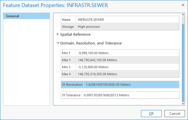

I have a feature dataset that was created years ago by someone other than me. The XY resolution and XY tolerance of the FD is incorrect:
  • Presently:
    XY Resolution:1.62981450785392E-05 Meters
    XY Tolerance: 0.000130385160628313 Meters
  • Should be:
    XY Resolution: 0.0001 Meters
    XY Tolerance: 0.001 Meters

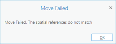

I want to do things with the FD like move a FC to the FD (by dragging and dropping in Catalog). But that's not possible due to the incorrect XY resolution and XY tolerance of the FD: Moving FC to feature dataset fails, despite spatial references [appearing to be] the same.
The FC's XY resolution is 0.0001 meters and the XY tolerance is 0.001 meters.
