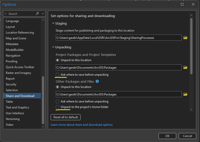

DougGreen
Just so everyone who pulls this up can see, here's what @AlfredBaldenweck was talking about.  I guess I would change my idea, in that case, to have the default behavior modified to those indicated in the section below.UnpackagingSetings.png

@DougGreen The Pro.settingsConfig file that @AlfredBaldenweck  mentioned is designed to allow you to deploy ArcGIS Pro with your default settings for yourself and other machines in your organization running the application.
As a recap, the default unpacking location is "C:\Users\USERNAME\Documents\ArcGIS\Packages". The setting can be changed to "Ask where to save before unpacking" or "Unpack to the project's home folder" by the user. The setting can also be changed and locked by an admin.
