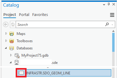

This is what the table looks like in the Catalog pane:

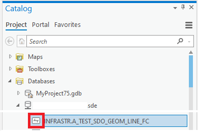

Catalog seems to use a generic rounded rectangle as the icon. Likely because SDO_GEOMETRY columns can accept features with multiple geometry types (point, line, polygon) within the same column. So Catalog doesn't know for sure what kind of data might be stored in the column, and therefore can't display a specific icon for points, lines, or polygons.
Whereas an SDO_GEOMETRY feature class that was created using ArcGIS Pro does get registered with the geodatabase. So Catalog knows what geometry type it is.

Since my SDO_GEOMETRY column is constrained to a specific geometry type (point, line, polygon), and since there is only one geometry column in the table, I'm wondering if Catalog could be enhanced so that it recognizes that constraint, and displays the appropriate symbol (point symbol, line symbol, or polygon).
That would make it easier to determine what the geometry type is when using Catalog (assuming the table name doesn't give us a hint). Otherwise, with the generic rounded rectangle icon, we don't have an easy way to determine the geometry type from within ArcGIS Pro.

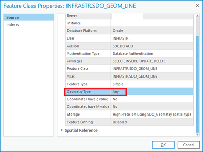

Similarly, I wonder if the Catalog Properties could also indicate the geometry type if it is constrained by the index. Currently, the SDO_GEOMETRY column is listed as Any, not as Line.
