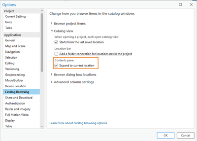

@NaicongLi Doesn't seem to be working for me. I am using Pro 3.2. I think I have enabled correct settings:
project > options > catalog view > expand to current location.
I have also started a new project.
Any ideas?
NaicongLi
@SamPalmer Please make sure that you did check "Expand to current location" in the Options dialog box, as in the screenshot in my earlier comment, repeated here:
By the way, if "Add a folder connection for locations not in the project" is also checked under "Location bar" above, then the path you pasted in the Catalog view Location bar would automatically be added as a folder connection in your project, and the folder expansion would happen under the Folders project container instead of under This PC.
