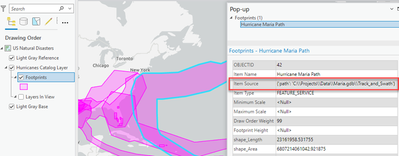

@TanuHoque thank you this is great to show the footprints, what I want to do from here is when i click on a footprint (ex. a raster rectangle) then have it populate in the data with option to copy where on a harddrive its located. Any ideas if any tools exist to do this it would be very much appreciated.
TanuHoque
@DALINEPJ
when you click a footprint polygon, it shows the path of the dataset in the popup window like below.
Is that not helping in your workflow? Maybe I misunderstood your ask. If so, would you mind provide me a bit more information to help understand.
TanuHoque
Closing as this can be achieve with catalog layers.
